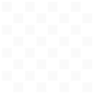

In addition, PWP's Checkerboard Transformation is capable of displaying similar test images and you can use it interactively to find the threshold for the apparent (i.e. those that you can see) Black Point and White Saturation by adjusting the brightness of one of the checkerboard colours by one pixel value until you start seeing the difference between the Checkerboard squares using Ctrl-Shift-Click on the Colour Picker Brightness Slider.
These are the initial settings I use. The easiest way to do that is to save them from Checkerboard transformation and recall them as needed.
For the Black Point, set Preview Border Color to Black; for the White Saturation, set Preview Border Color to White.

This is an exaggeration of how the Checkerboard images will look like - in reality at the threshold of seeing, the differences between checkerboard squares should be barely perceptible.
Vastly Exagerated Black Point Checkerboard Image.jpg (3.94 KiB) Viewed 55688 times
Vastly Exagerated White Saturation Checkerboard Image.jpg (2.62 KiB) Viewed 55688 times
