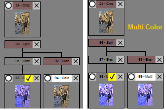

Post by davidh »
1. add the Color balance, pull the nod of any of the curves enough to make the effect exaggerated for better visibility, click OK
2. reopen the transformation -> the curves look reset though the effect stays unchanged
3. copy the image to a separate branch -> the color effect is is no longer there
This does not happen when probing the image is used.
Multicolor Balance works as expected.
Color Balance curves.png (26.12 KiB) Viewed 1213 times
