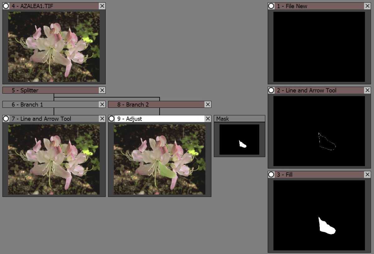

This is a replacement for the Mask Spline tool, useful mainly if you want to create a mask with a smooth, sweeping curve. Using the Mask Spline tool, to get such a curve you have to insert a lot of control points as it tends to connect control points with somewhat straight line segments. This is fine if you are copying a shape that has a line of fine detail and/or straight sections, but not so good for tracking a long smooth curved area.
First you need to read up on the Line and Arrow tool which can produce curved lines using a different type of spline algorithm than the Mask Spline tool. If you select curved lines instead of broken lines, each control point has two additional control points that let you control the slope and velocity of the curve around the control point.
1) Use the Line and Arrow tool to paint a thin, white line around the object you want to mask. To create a closed curve, you will need to drag one of the endpoints over the other.
2) Use File New to create a new 8-bit black and white image of the same dimensions in pixels as the image you want to mask.
3) Copy the Line and Arrow transformation to the File New command. This paints a white line on the black background. To copy, Ctrl-click on the Line and Arrow transformation, click on the File New transformation, and then click the Copy button in the image browser (you may have to click the down arrow button first to display the copy button).
4) Use the Fill tool to fill the interior of the curve with white by shift clicking anywhere in the interior.
Now you have an 8-bit black and white image that has a black background and is white within the region you defined using the Line and Arrow tool. This image can then be selected as a mask for other transformations applied to the original image, such as Adjust or Brightness Curve or Composite.

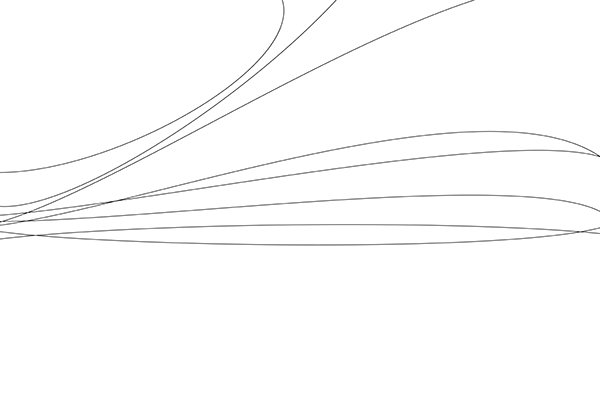

Thought I would add a comment or two, in addition to what Jonathan and others have already posted, just to give you an idea of what I was trying to accomplish. A while back (as in years) I did up a series of images that combined a mask (or two) in combination with hand drawn lines across the page to get some graphic results (although they were based on images I had taken in the American southwest, the results were markedly different from a photographic image). At that time, I did not obtain smooth lines by free-handing the lines, so thought I would give it another try. As a result of my questions and Jonathan's responses, I tried the Line and Arrow tool. The lines were drawn across the entire image, so did not need to be a completed circle, and as I indicated, I wanted them smooth.
Attached are two images, one of the originals from a while back and the second, one that I am using to generate masks, by flood filling each section with a mask, then using that mask in another image. I also used the line image as a mask for the section outlines.
Hope this clarifies.
