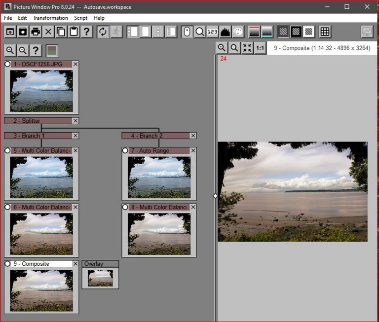

When loading a previously saved workspace script, then a start image (8,16,24,or 48bit), the program shows a system busy mouse icon and then disappears from the desktop.
When forming the script in the Browser prior to saving it; a sequence of identical error messages appeared when opening the first Multi Color Balance transform in Branch 1... ..."Internal Error: Zoom Factor = 0"... After OKs of all the error messages, the Mult Color Balance transform would open and no further problems with forming the workspace branches.
Note: the multiple error messages happened if the first Branch 1 Multi Color Balance transform was written after a Branch 2 Autorange transformation.
The script consists of two branches whose purpose is to:
1) adjust to Full Range with the Multi Color Balance transform with neutral Black and White points followed with a Multi Color Balance transform to correct mid-tone color casts
2) adjust to Full Range in the HSL-L color space followed with a Multi Color Balance transform to correct mid-tone color casts
3) Preferentially Composite-Blend the two branches

There was a problem in Autorange that has been fixed for the next release.
