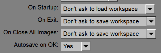

5) To avoid constant nagging, I turned off all the Workspace prompts in Settings and left Autosave on OK on. To return to the previous workspace: Script/Open Workspace Script/Load Previous or Autosave - if the PWP didn't crash, they should be the same, shouldn't they?

1) If enabled, Autosave.workspace is saved every time OK in any transformation is clicked on.
2) Previous.workspace is always saved when PWP is closed (but not when it crashes), regardless of Settings.
3) Both of them are saved in the default Workspace Scripts folder (On my Windows 10: C:\Users\[myself]\Documents\Picture Window Pro\Workspace Scripts\)
4) Both of them are saved with top image names, not TIFF copies of them, which makes sense, I think.

- Capture.PNG (13.84 KiB) Viewed 1594 times
