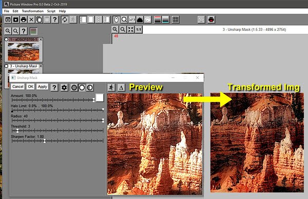

Halo Limits still reversed?
Ref: PWP8.0.exe 02-Oct-2019 & 21-Sep-2019 Help
The USM transform Preview does not match the transformed image version:
Reversed Halo Sliders.jpg (75.26 KiB) Viewed 111932 times

I don't think the Halo Limits are revesed.
From the screen shot it looks like you forgot to click the (running man) button above the preview image to apply the settings to the full resolution output image. This button would be grayed out if the two images were synchronized.
Re: Bug fix release 2-Oct-2019
The "Transformed Img" is a screenshot image area of the USM transform OKed resulting image... ...den...
Edit: Clicking the 'running man' before clicking 'OK' does make the Preview and Transformed Img match. Is it intentional that an OK no longer executes the transform? ...den...

I am not seeing this here - when I click OK it executes the transformation when the running man is black. Can you reproduce this?
I cannot duplicate this after doing a system restart.
I initially did the following:
1) downloaded/saved PWP8.0.exe 02-Oct-2019 zip
2) Renamed existing Program Files/.../PWP 8.0.exe to PWP 8.0_190927.exe
3) opened 02-Oct-2019 zip and copied its PWP 8.0.exe to Program File/.../
4) opened PWP8 program to verify the new exe version and tried the USM transform with the Input image as illustrated.
Again, after a system restart I am unable to duplicate the initially posted anomaly.
