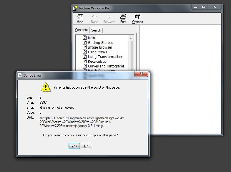

I'm running Windows 7 Service Pack 1 on an i7 PC. The installation went OK, and on opening I'm presented with the app framework but of course no images. I find I'm not able to open images as they are not recognized. To test it, I opened your sample image of the bird. However, in doing so, this immediately threw up an error message:
Error pane 1.jpg (55.6 KiB) Viewed 11356 times
I pressed NO and got another error message:
Error pane 2.jpg (56.95 KiB) Viewed 11356 times

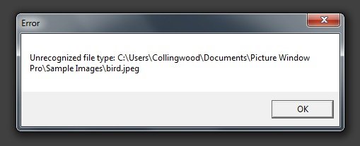

A second press of NO cleared the error message. Then I went to the 'bird' file and selected it. I then got another error message:
Error pane 3.jpg (14.91 KiB) Viewed 11356 times
I 'OK'd that and got a further error message: (hmm, can't add any more images). Basically it said 'error reading file'. OK-ing that just takes me back to the 'open image file' pane again.

Wild guess - is the file really named .jpeg? Have you tried renaming it to .jpg (take out the e)?

Yes it is, believe it or not! But it doesn't make any difference, and in any case I can't open my own '*.jpg' files.

PWP 8 uses something call WIC (Windows Imaging Component) which is built into Windows to read and write jpeg and tiff image files. It should work under Windows 7 if you have all the latest updates installed. A number of others have been able to run PWP 8 under Windows 7 without problems.
If you are getting the error before actually opening the file, the problem could be in the File Open dialog box processing which I recently converted to use more recent Windows methods, but it should work from Windows Vista on.
The error message related to scripts seems totally unrelated to Picture Window which does not Javascript at all. Normally this would occur with an internet browser or something similar.
If you have installed PWP on a network drive, that may also be causing problems.
