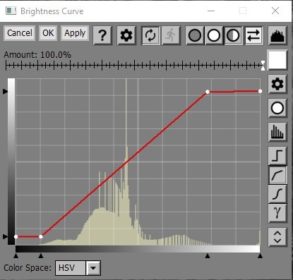

The histogram and curve above illustrate the situation. The small spike at the right end of the histogram represents the specular highlights in the image. This does not include enough pixels for the Levels and Color dynamic range to detect the specular highlights as the top end of the dynamic range. The detected dynamic range is represented by the innermost two of the four black markers at the bottom of the histogram. When you adjust the dynamic range, you are applying a curve to the image that looks like the red curve. The two markers on the y-axis represent the new dynamic range. Since the upper limit is less than pure white, all the pixels in the image, including the specular highlights that were ignored, are limited in brightness to the upper limit. Using curves, it is easy to adjust the central part of the histogram while leaving the specular highlights alone, but the dynamic range sliders in Levels and Color do not give you enough control over the tone curve to accomplish this.

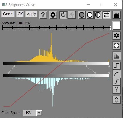

Using the histogram display as show above, you can keep the specular highlights pure white while you stretch the rest of the image to increase its dynamic range.
Levels and Color is intended as a simple transformation with a few simple sliders that give you crude control over the image. If you want precise control, you need to use Adjust instead which is much more powerful, but of necessity, more complicated.
