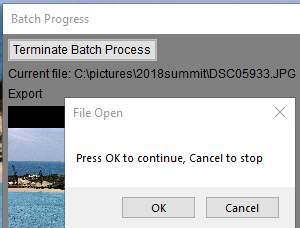

4) File | open multiple ... select single image -> message box "First file is already open: C:\picures\123.jpg;" click [OK] on msg box returns user to file open dialog. Works OK if select more than one image.
5) batch file open with two images, three transforms. [1] run current file only -> batch runs with 'batch completed' msg box. Click [OK] on msg box -> batch runs again with 'File open' msg box on top of batch process dialog. Click [OK] on file open msg -> batch runs again with 'File open' msg box on top of batch process dialog. Batch runs three times before the 'batch completed' msg.
6) same as #5 ['check mark'] Run all in test mode -> batch runs with 'File open' msg box on top of batch process dialog. Click [OK] on msg box -> batch runs but it doesn't look like image two was processed; hard to tell bacause the workspace images do not update (see #2).
Fixed for next release
The way to tell if Test is working is to place a breakpoint on one of the transformations to let you pause the batch operation once for each file as see what it has done so far.
