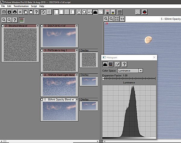

Step 1 illustration: Img 1 and Texture image; Img 1 Luminance histogram
Screenshot (1).jpg (67.15 KiB) Viewed 6476 times

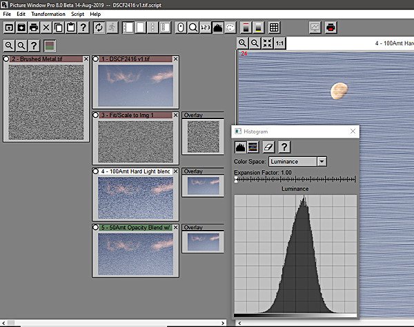

Step 2 illustration: Texture image fit to Img 1; Texture image Luminance histogram
Screenshot (2).jpg (67.67 KiB) Viewed 6476 times

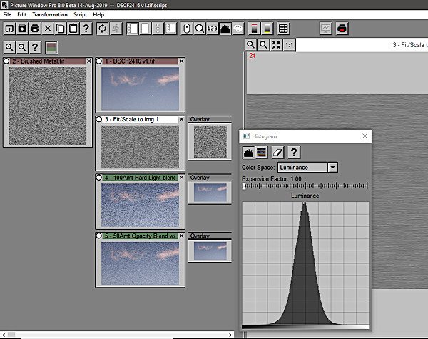

Step 3 illustration: Composite-Hard Light blend; Textured image Luminance histogram
Screenshot (3).jpg (72.85 KiB) Viewed 6474 times

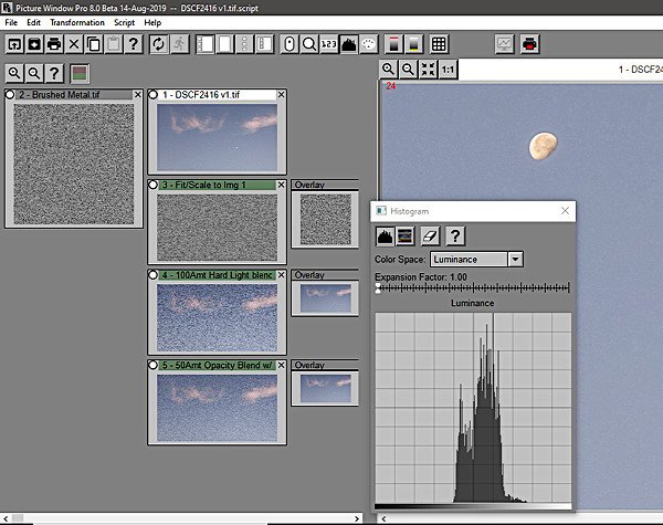

Step 4 illustration: opacity Composite-Blend; adjusted Textured image Luminance histogram
Screenshot (4).jpg (71.22 KiB) Viewed 6474 times
