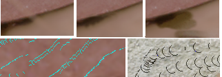

I was cloning off a dark noisy part from an image using Lighten Only mode and Linked cursors.
At a certain moment, I think when I was releasing the mouse button, there appeared a lighter streak aiming to the upper left corner of the image : top left crop in attachment.
I cloned it off using alternately Darken Only and Lighten Only mode: top middle crop in the attachment.
When I finished and reopened the Clone dialog to add some more touches, I got a dark muddy patches where I was also cloning. What is interesting is that they are in the place where I was using Lighten Only and that they are not the last strokes I did before clicking OK: top right crop in the attachment.
Until I reopened the Clone dialog, the preview did not show any such patches. After that the patches remained permanent part of the image, always visible in the preview.
I repaired the cloning a few times without success. I also saved it into a workspace script and closed PWP without reopening the Clone dialog. After loading the script the muddy patches were there.
I also wonder where the muddy brown green color came from.
Tomorrow I will replace the Clone step to see what happens. I guess it all comes from the gost streak, even though it was cloned off and is no longer visible.
Another thing is that during the clonig the cursor was leaving circle trails when the image was zoomed 1:1 : bottom left crop,
and even when zoomed to fit: bottom right crop.
This is quite upsetting as once you activate the cursor, the trails are left even when you move just the mouse over the image without cloning anything - with no mouse button pressed, just going to the dialog controls and back to the image.
Also, they stay there for some time thus creating a whole net of trails before they are removed by the cursor moving over them again creating new trails.

I am aware of that. I have encountered the ghost streak problem several times before without being able to relate it to any particular action and without being able to reproduce it, that is why I have not reported it. I was usually able to clone it off without any after-effects.
This is the first time there appeared a darkened blotch like this.
Notice that the ghost streak is cloned off from cropped part of the image (top on the right), but a new thing is this muddy blotch.
