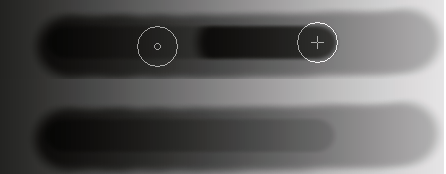

However, I have found something concrete.
1. clone a patch on the gradient starting in the dark part of it
2. clone another patch over the first patch - both circles must be at least partly inside the previous patch as is shown in the image -> notice how the patch darkens as soon as it enters the previous patch
3. click OK and reopen the Clone transformation dialog -> the dark part of the second patch disappeared leaving the patch lighter as it would have been if it had been cloned outside the previous patch
This means that if the source and the target area come from an already cloned part of the image you may never complete what you want unless you do all the cloning at one go without releasing the mouse buton. Whatever you clone from it and over it later with other independent strokes, disapears or gets lighter.
Transparency makes it even more difficult to see the problem, which was my case as I mostly used something around 75%.
It happens with all three Modes and both Brushes.
It does not happen if the source or target area lie outside the previously cloned part of the image
It does not happen if you add another cloning step to the branch. This might mean many such steps when a delicate work would be needed.

- Cloning problem.png (27.28 KiB) Viewed 8514 times
Re: Cloning preview inconsistency?
Have you tried setting Overlap to Yes?
Dear me! I have not. I saw it there but somehow...growing slow...
I am really sorry for having wasted your time.
Not a problem - perhaps I should make the default Yes instead of No.

I changed the default for the next release.
