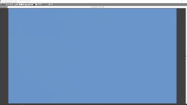

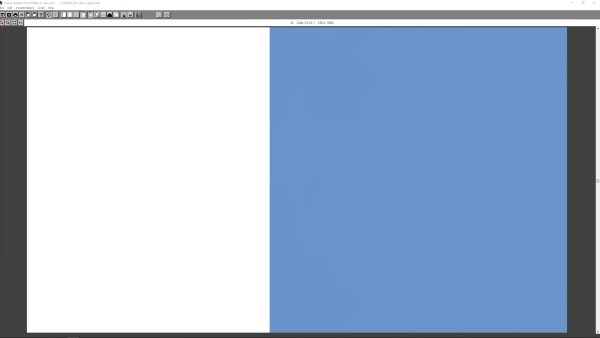

The top image was warped left to stretch the image left so that only the blue remained across the frame. Notice the right edge, which should not have been affected by the warp transformation (closeup in third image).
Posts: 4900
Re: Warp - Bilinear: Edge Artifact
The Warp transformation necessarily resamples the input image so it will not in general reproduce the kind of edges in your example. The area outside of the image is taken as black, so you get a dark blue when an edge is resampled. If the entire warp region is inside the blue you should not get dark edge pixels.
