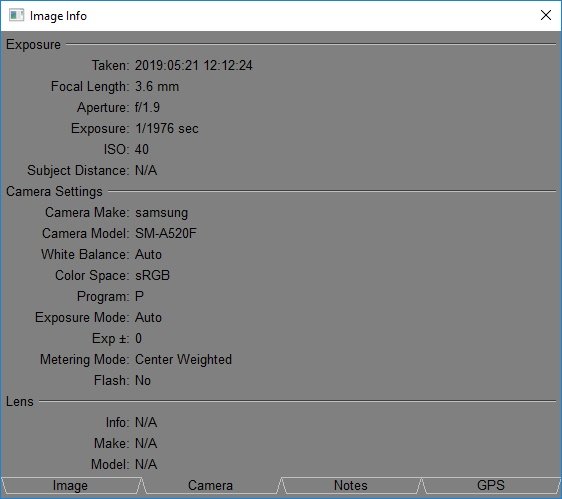

It just happened again with the 19 Jun 2019 beta. An entire session of 31 saved image files lost their GPS data.
I was monitoring the saved images (with the S icon) with PWP's Image info... and all of them as seen by PWP had their metadata intact. It wasn't until I started using these images in another application that I discovered the metadata for all 31 images was not preserved in the saved files.
Original image camera and GPS metadata:
Image camera metadata - original.jpg (32.46 KiB) Viewed 8220 times

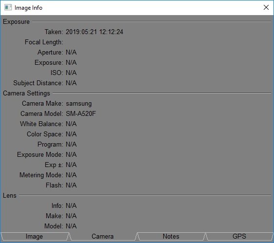

Saved image camera and GPS metadata:
Image camera metadata - as saved.jpg (31.32 KiB) Viewed 8220 times
Oh, I can't upload more than three attachments. The saved GPS image data showed N/A in every field.
