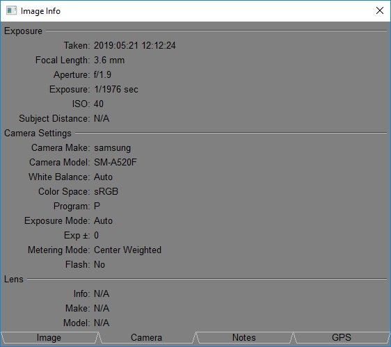

Original image camera and GPS metadata:
Image camera metadata - original.jpg (32.46 KiB) Viewed 8718 times

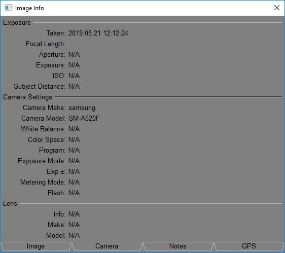

Saved image camera and GPS metadata:
Image camera metadata - as saved.jpg (31.32 KiB) Viewed 8718 times
Oh, I can't upload more than three attachments. The saved GPS image data showed N/A in every field.
