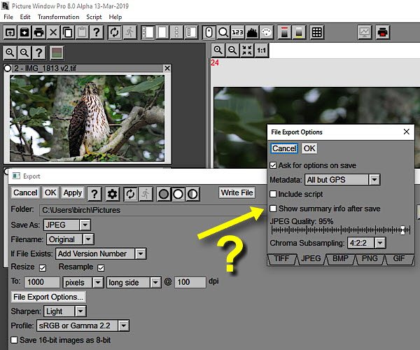

PWP8 13-Mar*: JPEG - "Show summary info after save"
Ref: PWP 8.0.exe 13-Mar-2019 and its *.msi
File\Preferences: setting not remembered from the previous installation if selected for File\Save and File\Save as... Needs to be re-selected if a preference.
Export: setting is ignored if selected as: (1) a transform setting; and (2) a Default or *.export script setting.
Did not check this for release 14-Mar-2019.

I am not seeing a problem with losing the Show summary info after save for JPEG files not being saved/restored from the preferences file. This file is not overwritten during installation so its settings should remain in effect.
JPEG summary is not currently supported in File Export or the Export transformation. Export is intended to be mostly hands-off so it can run continuously without user intervention.
Re: PWP8 13-Mar*: JPEG - "Show summary info after save"
Export: Perhaps this check box should be removed from the "File Export Options" for JPEGs if this is no longer the intent.
PWP8 03-13 Export.jpg (75.21 KiB) Viewed 2534 times
When I un-installed PWP8 8-Mar*; cleaned the registry; and installed PWP8 13-Mar*: the File\Preference to show the summary seemed to have gone missing and needed to be reset... ...at least for me.
Not a concern... ...there is a lot going on within the program and its updates/changes...
I like what is happening... ...Thank you.
Posts: 4875
OK, I thought you were talking about the JPEG options in File/Preferences, not the ones in File/Export.
