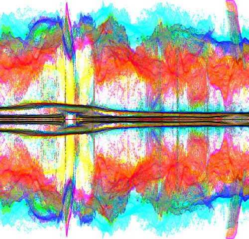

It's like a histogram turned on its side, reading bottom to top instead of left to right (for black to white...), with an actual representation of the left-to-right spatial distribution of the image... it's a little bit to wrap my head around.
But really mesmerizing to look at. I may have to try to take photos that will make interesting waveform patterns. Could there be a way to export the waveform images, other than a screen capture?
Re: Waveforms
... like this: (negative + tile + watercolor)
example_waveform v2.jpg (95.8 KiB) Viewed 4337 times
