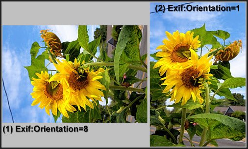

Portrait orientated images for both the Canon 350D and FujiFilm X100T camera will be PWP8 Save or Save As or Export with:
an Exif:Orientation = 8 [ Rotate 270 CW ]
If I subsequently execute a:
exiftool.exe -Exif:Orientation#="1" -overwrite_original -k
the image is rotated 90 degrees CW where Exif:Orientation = 1 [Horizontal (normal) ] and no backup file is generated [-overwrite_original] which is the correct orientation, matching that of the original image.
Added note: when taking portrait orientated images with these two cameras, I will generally rotate them 90 degrees CCW.
