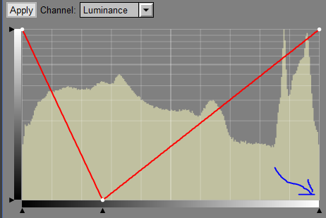

4) mask | luminance curve & create the stair step mask. Are [Invert] and [Overlap] supposed to change the curve or the mask?? The help says [Invert] button changes mask. But the [Invert] button has no affect on the mask; the 'invert' on the R setting menu (curve control) does invert the curve, so it should be so labeled. And what would [Invert] do if I am using the paint tool? It appears to change transparency? The [Overlap] button makes the paint tool erase!

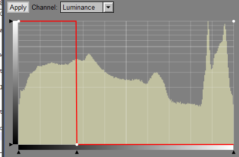

5) Now change above stair step graph to broken line. Check the end points - they seem to move. Change stair step to curve is same. Works OK on brightness tool graph.

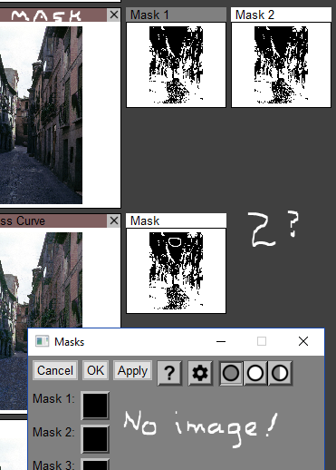

7) Open image. Select mask tool; this is labeled 'Mask 1' in workspace. Open Brightness curve transform, amount & select mask 1 & change mask 1. The updated mask image is attached to brightness & labeled 'Mask' in workspace; should be 'Mask 2?' That is, when there are multiple masks in workspace, they should be appropriately numbered. Now the mask tool image in workspace has 'mask 1' and 'mask 2' but mask 2 does not reflect the change made in the brightness tool. The mask image attached to brightness curve is labeled 'mask' and does reflect the change made in brightness amount control.
Now, if you return to mask tool, each mask should load corresponding mask #, but they do not. Just returned to mask tool and none of the three masks show up in mask tool!

5) image one = graph with step tool.
image two is same graph after clicking [Broken line] button. Is this correct?

7) image did not post. I shall try again!

5) Yes that is correct. Note that the stair step curve has it rightmost control point in the upper right corner.
