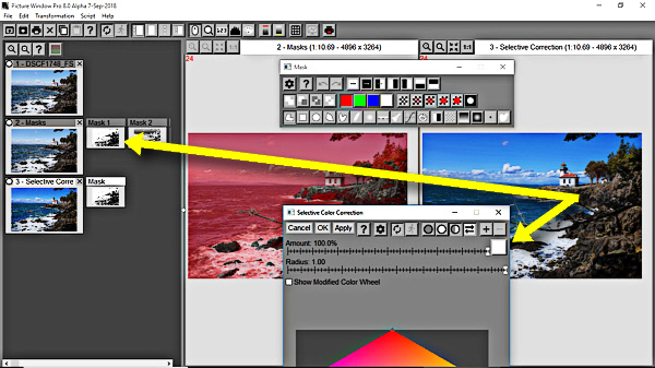

Amount 2-Mask1 does load correctly into Selective Color Correction Amount control slider control:
Selective Color Correction Amount 2-Mask1.jpg (190.68 KiB) Viewed 4665 times

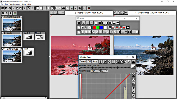

but does for Color Curves:
Color Curves Amount 2-Mask1.jpg (181.5 KiB) Viewed 4665 times
I only tried the Color Curves transform to see if this applied to other transforms...

I assume you meant "Amount 2-Mask1 does NOT load correctly"?
I am not seeing the problem you describe here, although I did notice that if you edit the mask in the Masks transformation and leave it open, the changes are not updated in Selective Color Correction until you click OK on the Masks transformation to cause the edit to propagate.

You are correct and I am unable to duplicate the first illustration with Selective Correction and a Mask 2-Mask1 mask... ...with a new program session during the same OS session...

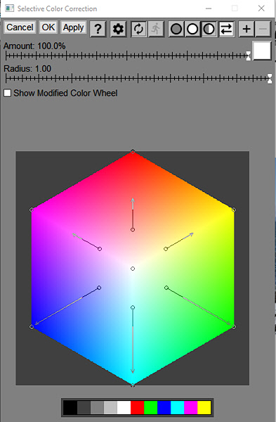

FYI... ...the Selective Correction settings file is a modified ElieD Velvia Effect with added Yellow and Magenta vectors...
Screenshot (6).jpg (133.83 KiB) Viewed 4589 times
Corrected setting file script:
selective_correction 0 npts 13 saveasmask 0 nonlinear 1 colorspace 0 current -1 showaffected 0 probesize 0 showcw 0 r 1.0000 amount 0 1 0 0 ″Amount: ″ ″Mask″ display 2 sync_scroll 1 auto_preview 1 point0 ffffff ffffff 0.0000 point1 ff ff 0.0000 point2 ffff ffff 0.0000 point3 ff00 ff00 0.0000 point4 ffff00 ffff00 0.0000 point5 ff0000 ff0000 0.0000 point6 ff00ff ff00ff 0.0000 point7 6666ff aaaaff 0.0000 point8 8ff08 aaffaa 0.0000 point9 ff0808 ffaaaa 0.0000 point10 fffe19 ffffaa 0.0000 point11 66feff abffff 0.0000 point12 ff66fe ffabff 0.0000
