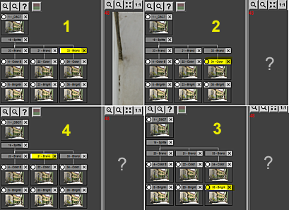

Some more observations regarding the empty previews.
1. turn off the preview window using "Show browser only" button
2. go to the branch box to clone from - image no 1, the branch box left to the highlighted one
3. clone a side branch from it
4. turn on the preview window using "Show both image browser and image" button:
-Image no. 1 shows the part of the preview after the "Show both image browser and image" was clicked. The current image is highlighted.
-The other three image show the empty preview window after they were clicked on.
-The image no. 4 shows that even the image to clone from has no preview when clicked on. This happens most of the time but not always.
If you click on a cloned image to make it current (image 2 or 3) before you turn the preview window on, their preview will also be then displayed.
