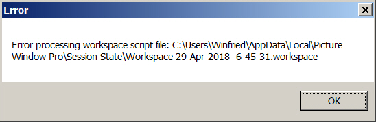

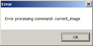

Again I had problems with saving *.jpg, but not with tif.
On Quit I saved the workspace.
Restoring the workplace from last session results in errors (see attached images)

It looks like a number of the images did not get written out to the workspace file. It may have something to do with the splitter you used, but I will have to experiment to see if I can reproduce the problem here.
Re: Problem with restore workplace from last session
I tried creating a number of different workspaces both with and without splitters but I was unable to create a case which did not restore correctly when opened. If you have any more information about what was in the workspace when you saved it or if you can create a workspace that does not get restored after being saved, please forward me the information -- ideallyi a screen shot of the image browser for the workspace before saving it.
I found and fixed for the next release one bug that may have caused the problem you were seeing. Let me know if you continue to see the problem going forward.
