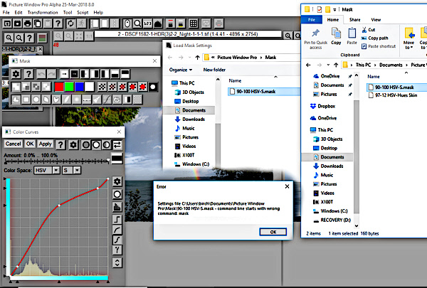

1) opened an image into work space
2) opened Transformation/Color/Curves
3) opened Mask Tool - Color Range and made 2 setting files, saving each
4) files were saved in the Mask folder without any extensions, showing only names when using File Explorer
5) Load mask dialog file names were not visible and would not load after manually adding a "*.mask" extention resulting in error message as follows:
"Settings file C:\Users\<*>\Documents\Picture Window Pro\Mask\90-100 HSV-S.mask - command line starts with wrong command: mask"
composite ScreenView:
Load a saved Mask-2.jpg (255.64 KiB) Viewed 6301 times
90-100 HSV-S.mask in text format:
mask 0 nx 4896 ny 2754 mask_color 0 mask_transparency 3 initial_level 0 n_op 0
This a HSV-S color range selection of the workspace image's approximate 90% to 100% HSV-Saturations at all Hues and Values.
