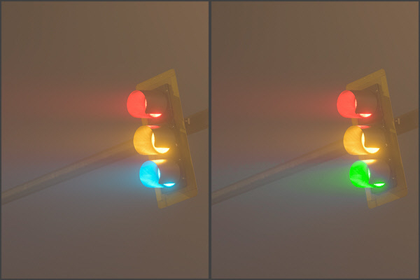

Was out one recent foggy morning and captured an image of a traffic light (actually shot three images - one for each red/green/amber - then composited them in PWP, using "Lighten" blend mode - worked like a charm) with the lights emanating the rays into the fog.
Tried a number of attempts to exaggerate the light "beams", but found it quite difficult to do any transforms on the beams that did not also affect the surrounding background/fog. This included different composite blend modes like "Soft Light" etc. Also tried doing some masking to separate the beams from the background, but that didn't work so well because of the incredibly gradual fall-off from one to the other (and the pole cutting across the beams).
I'm wondering if anyone can suggest a PWP method/transform/blend mode that better suits my intent.

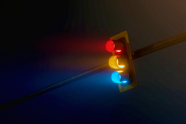

I have attached two images, one is the initial unworked, while the second is an image after some heavy processing (both Soft Light and Filter and other treatments, if I recall), just to show the type of effect I am trying for - however this image is way too dark in the background and extreme in the hues.
Separaing tones/hues

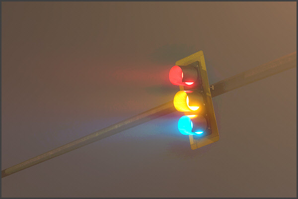

I tried the following which may or may not be moving in the direction you want to go...
1) File New based on the original image and using the eyedropper to set the color of the new image to the background color.
2) Difference to subtract the background from the original, giving a more or less black background. 3) Brightness curve to lighten the image, especially the darker parts 4) Composite with the background image in Lighten mode, adjusting the overlay amount slider to restore some of the background

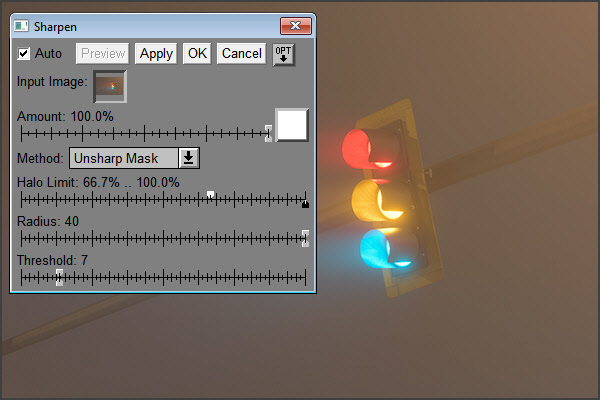

Try using a favored large radius sharpening method with a strong bias towards a dark halo... ...illustrated is USM but consider Bilateral and High Pass sharpening as well... A HighPass Sharpening illustration... ...den...

Jonathan, your approach actually looks like it works pretty well. I was looking for a more pronounced set of light beams without the background going crazy, which this seems to accomplish. I will have to play around with this a bit.

Yes, 'strong bias towards a dark halo' is the difference between the white and black Halo sliders of PWP's sharpening transforms... ... 'large radius sharpening' is also called Local Contrast Enhancement...
The Halo control can be manually duplicated with an image in PWP by:
1) create an "extreme" sharpened image version
2) Composite-Darken the original image to a preference Amount to simulate the Halo black slider
3) Composite-Lighten the resulting 2) image to a preference Amount to simulate the Halo white slider...
...using the "extreme" sharpened image version as the Overlay image in steps 2) and 3).
Another illustration using USM with a larger blur Radius and an increased Threshold to reduce the posterizing Jonathan points out that can occur... ...den...

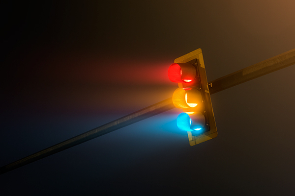

P.S. Perhaps add a small amount of a RGB darkening contrast curve to add additional emphasis to beams:

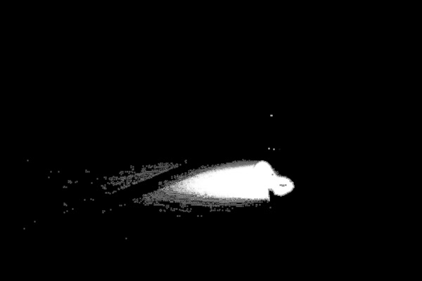

Just for fun... ...from the original image's HSV-H channel, a cyan hue range was masked......and using the Color Curves transform in the HSV color space the Hue and Saturation channel curves were adjusted to change the cyan light/beam to green... ...den...
Marv...
