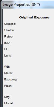

I was trying to save a file without the redundant properties listed under the Original Exposure label in the User Comments dialog box, see the attachment. But it cannot be achieved with the Save Image dialog box. There is no checkbox "Include Only User Comments". Unchecking Include Comments removes not only Original Exposure properties but also User Comments. To get the User Comments back it needs reopen the already saved jpeg image, reenter the User Comments and resave, which might increas image degradation depending on the Quality and Sampling setting.
The other method already mentioned, Copy and Paste, also removes both Original Exposure data and User Comments, but enables reentering the User Comments and save only then therefore once. A question is how big image fits into the Windows Clipboard and what else happens to the image inside the Clipboard besides stripping some of the its metadata. Also it is not a nice method since it happens outside the Picture Window, or at least I have such feeling.
PWP Copy tranformation under Geometry also creates copy of the image but does not strip the properties like the Windows Clibboard, so it evidently works differently. Perhaps it might offer a simple box with a list of options similar to the one in Save File (JPEG) that would enable preserving User Comments together with the Profile, Statistics etc. This copy feature would prepare the image for saving later in whatever format. Just an idea.
David
