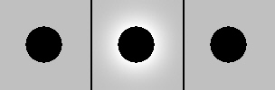

From the paper: "The simplest way is to use the Sharpen transformation and perform Unsharp Masking with a large radius setting. The problem with this method is that, depending on the image, it can create broad halos around light subjects against a dark background or dark subjects against a light background."
True. Halos, though, seem to be less of a problem with Fuji X-Trans files. Fuji X cameras have a different color filter than the standard Bayer pattern. It is less regular.
For LCE on these files, a radius around 5 and an amount of 5 to 10 percent works well. I usually dial down the white halo slider to 50 percent, too. And perhaps crucial, I set the sliders on the histogram at the bottom of the Advanced Sharpen dialog to exclude a small slice at the left.
I do this many steps after raw conversion; am I only fooling myself?

I would not expect the type of dither pattern in the sensor to have an effect on halos with large radius unsharp masking.
Here is an example:
- Original/Unsharp Mask/Bilateral
- LCE.jpg (4.76 KiB) Viewed 10366 times
