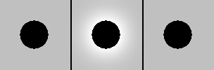

Re: Local Contrast Enhancement
I would not expect the type of dither pattern in the sensor to have an effect on halos with large radius unsharp masking.
Here is an example:
Here is an example:
