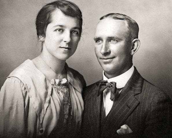

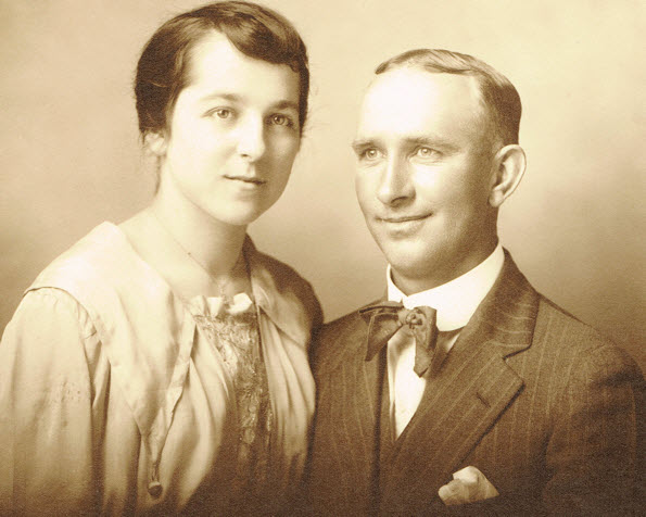

I recently had the occasion to restore a vintage faded sepia print from the early 1900's and re-discovered from my archives a SplitTone ColorCurves file that I adapted from a Photoshop tutorial somewhere/sometime past... ...the suggested *.cc curves may be of interest...
Step 1... ...start with the best possible scan of the faded print...
Step 2... process the resulting scan file to restore best possible (preference) gray tone contrasts, details, eliminating noise, specks, dust, etc... ...then Extract its Luminance channel and Convert it to 24 or 48 bit color...
Step 3... Open the Color Curves transform with the resulting Step 2 image version as the Input... ...using the the upper OPT-ions, Load the *.cc file whose text is shown below... ...the SplitTone curves will tend to show slight bluish tints below a 50% Luminance transitioning to slight reddish tints above a 50% Luminance...

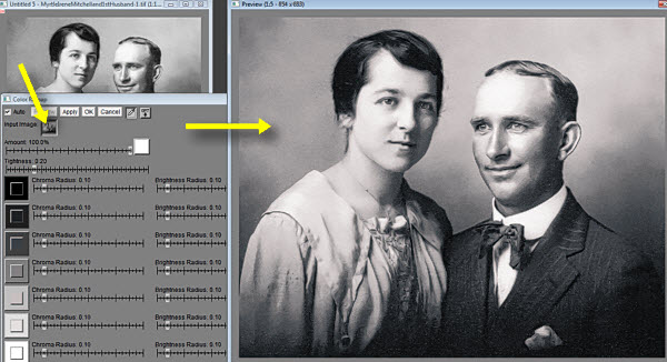

Yet... ...another SplitTone alternate using PWP7's Remap transform...
As suggested previously Convert an 8 or 16 bit BW image to 24 or 48 bit color where R=G=B to use as the Input image to the Remap transform:...
Again... ...Copy the following text [PWP7 *.colorremap file format] to a plain text editor (Notepad), then 'Save as' <name>.colorremap in a favored folder location. Use 'Remap OPTions -- Load' for the transform color pair/settings... ...the"#" lines designate 'comments'...

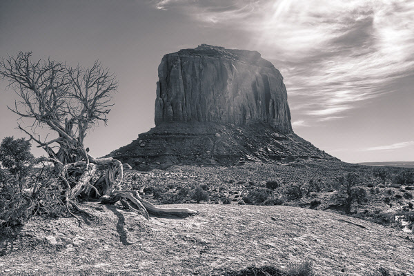

SplitTones and a fortuitous Fuji X100T lens flare...
