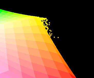

Charles, I had the chance to run a test with ColorThink at a friends place.
One can plot colorspaces, and also load pictures to show their actual gamut.
The solid is Chrome2000D65 and the cloud of points is the image.

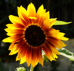

The image is one of a sunflower, light from back, developed to ProPhoto.
The image here is in sRGB for better appearence on the web.

I think you may be misinterpreting what is happening with raw files and camera profiles. Here is my understanding:
Digital camera sensors simply produce a set of RGB values which are not referenced to any particular primaries. Determining the actual camera color gamut is actually very difficult as it cannot be measured directly (there are some papers on this on the web). Camera manufacturers generally try to produce RGB values compatible with sRGB or Adobe RGB so it makes sense to use whichever of these color spaces you specified in your camera settings unless you have a custom profile created specifically for your camera. Simply tagging the RGB data with a wider color space does not recover any otherwise clipped color data - it just reinterprets the raw RGB values as being from an arbitrarily wider gamut than normal. When the raw converter in turn converts the tagged image to the working color space, it uses perceptual color mapping so the image gamut is simply shrunk to fit the working color space gamut unless the working color space is also a wide color space. In other words, using a wide color space as a camera profile is really a useless exercise that in the end is at best more or less equivalent to a saturation boost.
