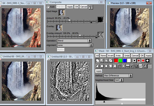

1) Sharpen Img0 to an Amount 100, creating Img1

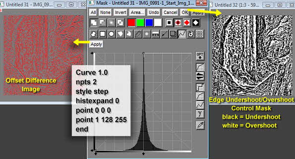

2) Offset Difference Img1 minus Img0 at Amount 100, creating Img3
3) Mask Img3, creating EUOCM using Mask Tool – Brightness Curve…
4) Mask Img1, creating MEM using Mask Tool - Texture… …leave ‘active’ on Img1… …Neighborhood Size should be as close to the Sharpening radius used to create Img1 as the setting allows…
5) Composite-Blend where: Input = Img0; Input Amount Mask = MEM; Overlay = Img1; Overlay Amount Mask = EUOCM… …adjust mask amount black/white sliders to preference while monitoring 1:1 Zoom factor Preview image areas to avoid viewing anti-aliasing artifacts…
In the illustration above, Img0’s smooth/minor edge image areas are sharpened [blended] to a 90% amount while the major edges are sharpen to a 45% amount [ratio of smooth/minor edges to major edges is 2:1] with edge Overshoots 2/3’s [67] of edge Undershoots [100] of Img1… …as MEM is ‘active’, Img0’s masked smooth/minor edges and major edges image areas can be adjusted with a Mask Tool None or Undo; re-adjustment of the threshold setting [black slider]; and a lower-left Apply Add and the Preview will auto update if checked…

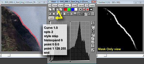

...3) Lower-left Apply Overlay a Mask Tool – Brightness Curve Step curve [0,0], [50,0], [50,100], [100,100] to Img0… …[OPTions Load the curve from a previously Saved curve]…
step 3_major_edges_Overshoot_mask.jpg (46.89 KiB) Viewed 14056 times
Leave the Mask Tool ‘active’ on Img0 allowing if preference re-selection of a major edges threshold/range with a None and repeat of steps 2) and 3)… …if a transform’s Preview Auto is checked, Preview will update…
Open any one of PWP’s sharpening transforms/methods using Img0 as the Input Image and the suggested mask as the Input Amount Mask… …mask black controls the amount of sharpening to occur in Img0’s smooth/minor edges and major edges undershoots… …mask white controls the amount of sharpening to occur in Img0’s major edges overshoots… …suggested white slider amount to be approximately 10% of the preference black slider amount while monitoring 1:1 Zoom factor Preview image areas to avoid anti-aliasing artifacts… …for example, if the black slider preference setting is 70%, then most likely the preference white setting will be near 7% or 0% to avoid objectionable white edge halos…

...4) Perhaps this will also help... ...when performing steps 2) and 3), switch the Mask Tool to show Mask Only on the applied Img0 image. Notice the subtraction of the potential undershoot image areas from the major edges when step 3) is performed where the 50% tone step curve acts as a threshold separating major edge range undershoots and overshoots.

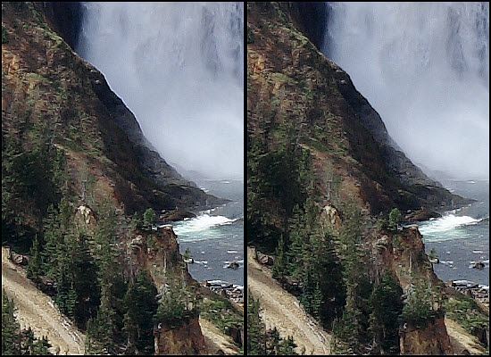

The following example is a side by side 1:1 Zoom factor image area crop. On the Left is a Heavy Sharpen No Mask Amount=70 Preview and to its Right is the suggested steps 2) and 3) Input Amount Mask where mask black=70 and mask white=7…
Have fun experimenting!!!...
