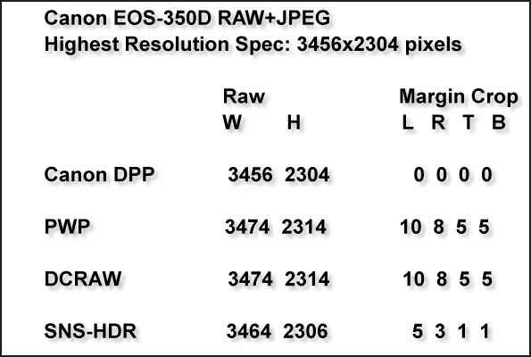

Found it... ...have these in memory anyway but the attached illustrates that different raw converters can produce different dimensioned pixel tiffs from the same camera raw file... ... I will sometimes mix channels from differing converters, so margin cropping to a common size for 1:1 registration is important for maintaining recorded sharpness...

Thanks, Den, for this response and also the previous one.
I resized the TIF created from the Raw file conversion to the same pixel length and width as the JPEG. (Hadn't noticed these differences previously.) With this modification, the mask created from the original JPEG worked perfectly with the modified TIF.
I didn't realize that the conversion of a Raw file resulted in different dimensions than the out-of-camera JPEG for the same image. In my case, it contained 1.6% more pixels (0.72% more pixels on the long axis and 0.92% more on the short). And now you say that the dimensional results vary from Raw converter to Raw converter. You learn something new every day.
