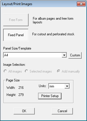

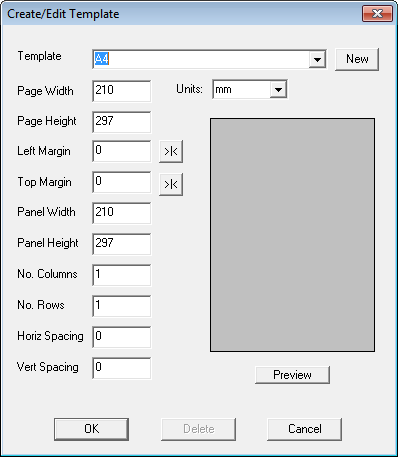

My images in the workflow are in A4 aspect ratio. The workflow ends with an Album widget. I'm trying to print to PDF, one image per page, borderless. I'm using PrimoPDF as a PDF printer driver.
Please take a look at the attached screenshots. Even though the Page and the Panel are specified to the A4 size, the page size seems to be: 216x279 and it does show margins. Pressing the Printer Setup button and trying to change the page size in the printer driver (it was set to A4) interestingly doesn't change the 216x279 value reported by PWP. What am I doing wrong?
Cheers!
Cheers!

I discovered a bug in second dialog you show. I will include a fix for it in the next release, which will be issued within about a week.
