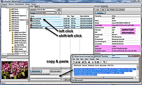

I routinely batch process the following EXIF tags using ExifToolGUI to multiple image files [CR2, JPEG, and TIFF] contained in a folder:
-LensType#=234 -Exif:LensModel="Canon EF-S 17-85mm f4-5.6 IS USM" -Exif:LensInfo="17 85 4.0 5.6" -Exif:Artist="...den..." -d %Y -Exif:Copyright<"(c) $Exif:DateTimeOriginal IMAGEs by DEN" -Exif:ImageDescription="-"
ExifToolGUI and Part 3a Command Line Option set.jpg (82.34 KiB) Viewed 6316 times
Perhaps you could do something similar with the tags of particular interest to you.
There is a dated 2013 pdf [750 KB] describing what I do if of interest that I could upload to my website for your download.
