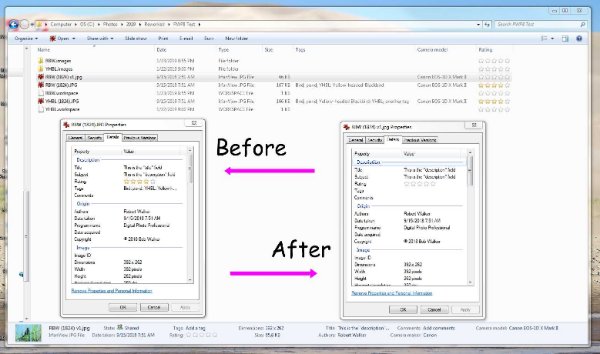

Here is a screenshot. File RBW (1824).JPG is an original jpeg output form Canon's DPP software. I opened it in PWP 8 by dragging it to the workspace. I then saved it using the "Save as" widget, generating the RBW (1824) v1.jpg file.
I then right click on each file in a Windows explorer window, select "Properties" and see what it says in the Details tab for each file. The Before/After windows show that The "Title" field has been replaced with the Description field. The Ratings field has been removed. The Tags field has been removed. Everything else I check seems to have been preserved.
Thanks,
Bob W
Thanks,
Bob W

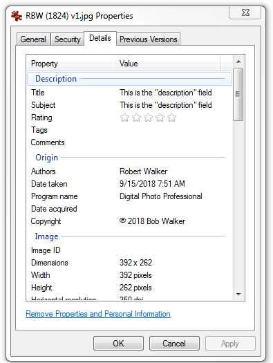

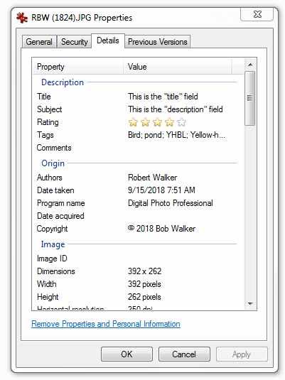

It looks like the screenshot image got downsampled to where it is unreadable. Here are two images, just of the properties dialogs.
- Prop-orig.jpg (35.01 KiB) Viewed 7411 times
- Prop v1.jpg (34.98 KiB) Viewed 7411 times
