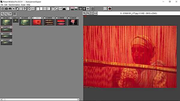

This is how it looks like. I ended up with the Copy option and Write File button in Export for each image in turn - there were only five for this job.
