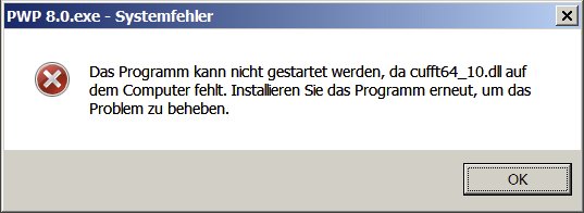

I just tried to install the new version (Installer version), but I got the following error message:
It says that a dll is missing.
I guess the name of the dll should be "cufft64_100.dll"
Maybe a typo in the configuration script.

cufft64_100.dll should be there in the install file. Can you try downloading again and trying the install once more. I tested the installer before uploading it.

I got the same error message when only updating PWP 8.0.exe.
Apparently, the new exe is looking for cufft64_10.dll instead of cufft64_100.dll
When I renamed cufft64_100.dll to cufft64_10.dll, the program would start but when doing a ctrl-F shortcut for a full screen image display, Win10 locked up.
I did a hard restart and re-installed PWP 8.0.exe (v8.0.4).

I think you probably need to download the full installer and try again. On my computer, installing creates the correct dll and it works OK.
I just downloaded the msi file here and it is identical to the one I uploaded.

I just installed the new version and got the same error message ... except mine is not in German!

OK I see the problem -- I updated to a slightly newer version of the CUDA software and they renamed some of the DLLs. I should have a fix shortly.
