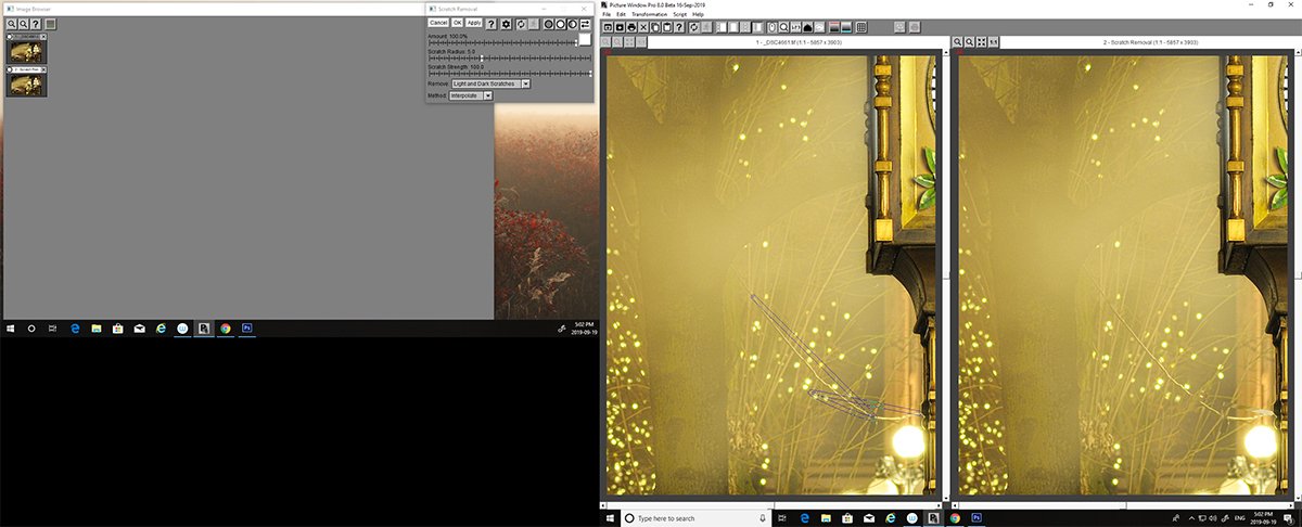

Sorry didn't respond earlier with a screen-shot. I am getting ready for an unexpected trip so haven't checked the forum for a bit.
Anyway, I just did the same exercise again and grabbed 4 screen-shots of various stages of the process. However, I am just attaching the last one to show you what the result is. If you want them all, let me know.
As you will note, there are 4 points - the far right (1), which is the first shift-click, the far left (2), which is the ending point of the beginning drag and drop, the second from the right (3), which is the first point I shift-clicked in the "bounding box", then dragged to it's current location (resulting in the "j" I mentioned in a prior post), and point 4 which is the third from the right. Immediately upon shift-clicking that fourth point, the new bounding boxes appeared. I dragged the fourth point down a bit to separate the boxes so you could see the "X" I mentioned - except it has a bottom leg between 3 and 4, which I did not initially mention.
Posts: 4892
Re: Bug fix release 16-Sep-2019
I see the problem now. The 4th point you insert is being inserted between the wrong two existing control points.
Here is the rule PWP currently applies to decide which two control points to insert between.
First it finds the closest control point.
If the closest control point is an endpoint, then the new point is inserted between the endpoint and its neighbor.
If the closest control point is not an endpoint, then the new point is inserted between the nearest control point and one of its neighbors. It chooses which neighbor to use by finding the nearest one to the new control point. In your case this was not the one you intended.
To avoid having the new control point inserted out of order, the safest way is to insert the new control point midway between the two control points you want to insert between and then drag it to where you want it.
Since the current rule is clearly confusing - at least in some cases - I will see if I can't create a rule that is more intuitive.
Posts: 751
Post by Marpel »
Jonathan,
Thanks very much. Your most recent explanation caused the light bulb to turn on.
I had assumed that inserting a control point inside an existing bounding box would merely recognize the two points on either side of it regardless whether they were endpoints or not. But as per your explanation, in my example, point 4 recognized point 1 because 4 is closer to 1 than it is to 2, even though point 1 was on the other side of point 3.
Your suggestion of adding a new point half way between the two points you wish it to be (then dragging it) seems to work fine.
