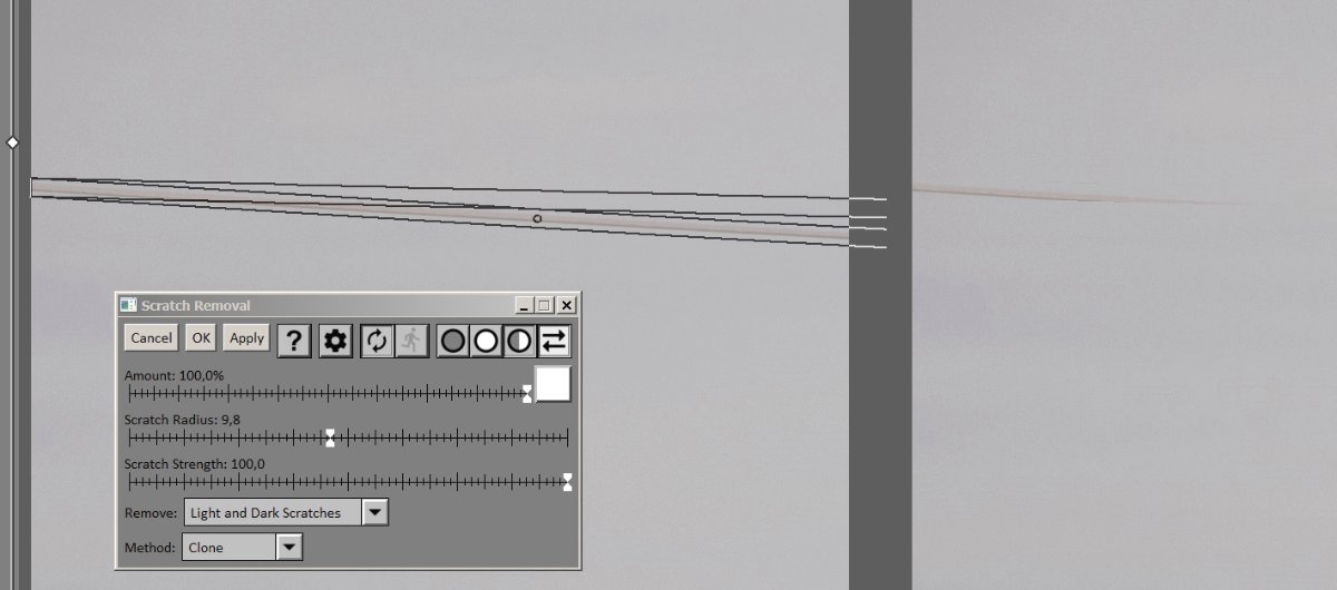

Thanks for the enhanced/reworked scratch-removal.
A test with some wires shows a small problem and a performace glitch.
To to my test the function might not work as expected if the end or the beginning is at the edge of the image.
The windows task manager shows that during this transformation just one thread is used.

Re: Bug fix release 15-Sep-2019
It looks like you may have created several overlapping scratches that are interfering with the current one, since there are some extraneous lines superimposed on the image. If you remove the extra ones it should work OK, with the possible exception of a small piece of the scratch at the very edges of the image.
Like Speck Removal, there is no simple way to multithread this transformation. For short scratches, it's not really an issue, but for phone lines that run across a large image, the compute time can be significant. I am still looking into ways to speed this up.

I found my mistake. I didn't understand how to create "the scratch-mask". But now all is fine.
