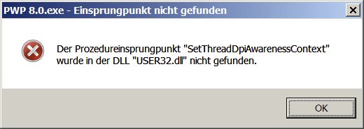

I tried to install the new version, but I got an error.
Maybe it is a result of my "old" Win 7 system?
Maybe it can be solved by deleting some of the files from the documents? Settings.Preferences?
Maybe I need a newer USER32.dll ?
I installed as a backup the version from 2019-07-20. Sp I am able to work :-)
P.S.: I just found out that the call "SetThreadDPIAwarenessContext"
probably needs Windows 10.
See: https://docs.microsoft.com/en-us/window ... esscontext

It turns out you need Windows 10 version 1703 or later to get the full benefit of the new high DPI monitor features. I am adding code to avoid calling SetThreadDpiAwarenessContext if it is not present and will upload a new version shortly. This should eliminate the error message.
On older versions of Windows, some things may not work as well. For example, the dialog box may resize when dragging between monitors but the caption bar may not.
If you have only one monitor or if you have two monitors with the same scale factor, you should be OK.
