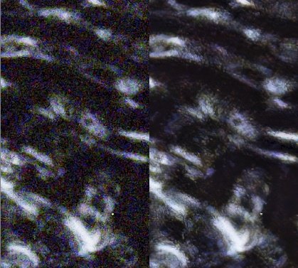

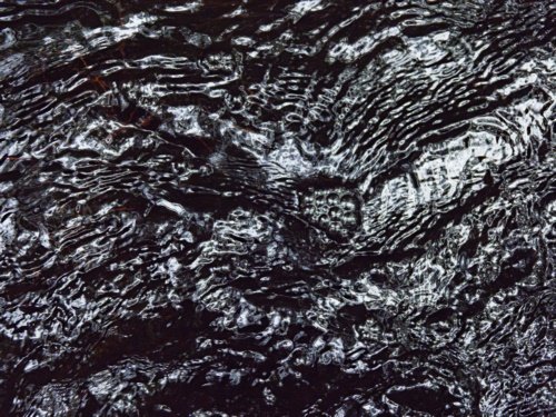

I have been hearing good things about this plug-in/standalone noise reduction package from Topaz. If you have the previous DeNoise 6 plug-in, the upgrade to DeNoise AI is free. This is a slow but pretty impressive package for processing high ISO images or images that have had their shadows lightened significantly. Attached is a side-by-side compare of a tiny 100% crop of a larger image of water reflections. It does a nice job of filtering out the speckle and chroma noise while leaving the underlying image detail more or less intact. DeNoise AI is slow, but usually gets good results although it may work better on some images than others.

Full Image
Full Image
Full Image.jpg (78.86 KiB) Viewed 5423 times
Compare 100% Crops
Compare 100% Crops
Denoise AI.jpg (48.55 KiB) Viewed 5425 times
