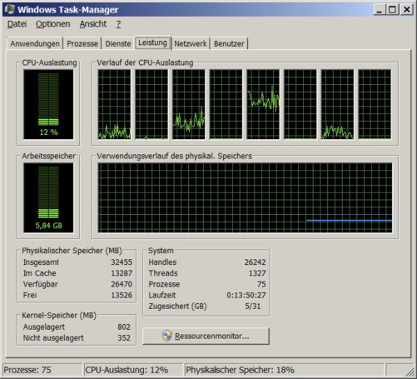

Maybe this helps:
It takes one thread of my 4 core/8 thread cpu.

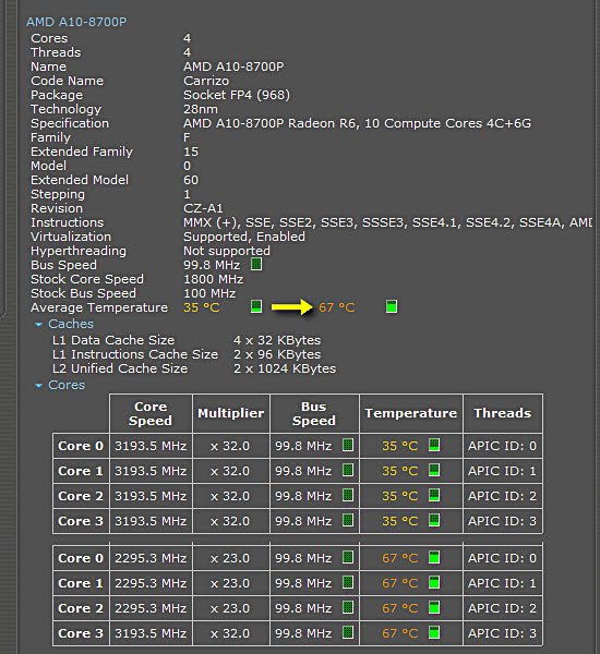

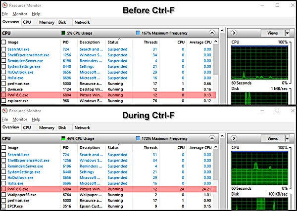

For my Win10 Home 64-bit OS, latest updates for December 2018 and the CPU/Core described below:
1) Core temperatures rose from 35C before to 67C after 1 minute of a Ctrl-F Display

2) PWP 8.0.exe CPU usage rose from <1% before to 24% during a Ctrl-F Display

Re: Ctrl-F Full Screen Display can significantly raise core temps
Maybe some other task was running in the background,
If there is, I can't see it immediately after turning off the Ctrl-F Display to see the Resource Monitor dialog... ...the tasks are displayed in descending order of CPU usage and there is nothing approaching the 24% ave usage of PWP8... ...and I cannot resolve the difference between the total CPU usage 46% and the 24% PWP8 usage.
So if this not occurring with your system/OS, don't spend anymore time... ...I do not intended to maintain a Ctrl-F Display for more that a few seconds under normal usage anyway.
Might be nice to have a Full Display comparison feature [Blink] for PWP8 for those using single monitor displays...

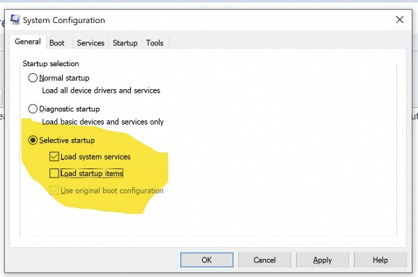

I'm sure you've already done this, but one thing to do to diagnose such performance issue is to start Windows without all the start-up items in the background, i.e. run msconfig.exe and select the following options before restarting the computer:
Annotation 2018-12-24 124438.jpg (30.41 KiB) Viewed 8688 times
This at least establishes a base-line for comparisons.
Another thing I do is to run the Microsoft/SysInternalsSuite utility Autoruns and activate the VirusTotal scanning of startup items. This may come up with false posutives, but those are rare.
