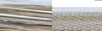

DXO Optics Pro 9 converted tifs, run through some PWP8 geometry transformations (e.g.Crop, Level, Resize) and saved with Include EXIF metadata checked on, fail to display in ViewNX2 or CaptureNX.
The images display as general icons in ViewNX2 and an attempt to open them fails with the message Unsupported file type.
Some other geometry transformations, like Add border (with at least one nonzero value) and Crop marks display distored in ViewNX2 - see the attachment, but in Capture NX they display normally.
This does not happen with PWP7 outputs.
Joint PWP8 EXIF and DXO converted tif EXIF mystery
- ViewNX2.png (67.06 KiB) Viewed 1934 times

Sorry for the ambiguous description.
Let me be more precise. The attached images are printscreens of tif images from ViewNX2 saved as PNGs for the attachment purposes.
I tried to find out more and have discovered that if an image is exported from DXO Optics Pro 9 without EXIF data (Remove EXIF data - ON), processed in PWP 8 using some of the geometry transformations mentioned before, it has no problem to display correctly in ViewNX.
I must emphasize that I bring this here not as a problem but only as a kind of peculiarity, probably on the side of DXO Optics EXIF data.
