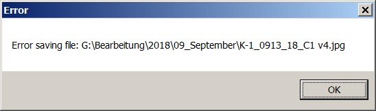

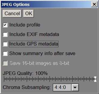

I am still playing with the options and got the following error message:
JPEG Options-01.jpg (30.78 KiB) Viewed 2866 times
JPEG Options-02.jpg (18.44 KiB) Viewed 2866 times
Maybe it gives some hint.
Posts: 4875
Re: Crash with Chrom Subsampling 4:4:0
It looks like WIC (the component of Windows that PWP uses the read and write JPEG files) was updated extensively between Window 7 and Window 8 and again for Windows 10. My guess is that somewhere in that process support was added for 4:0:0 or that a bug in 4:0:0 was fixed somewhere along the line.
