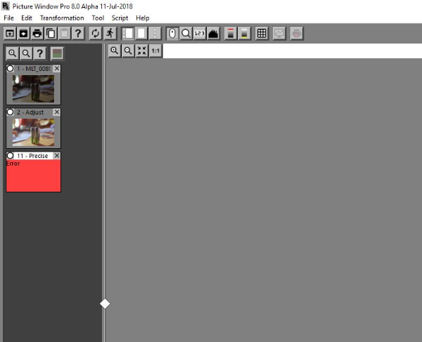

Shift+click works fine with the other Blur transformations (where applicable). Found one more thing - with Zoom Blur, it takes two clicks on the cancel button to stop the transformation, at which time you get a red image with the word "error" on it. You have to cancel out of the transformation to try again with new parameters.
(additional edit): Actually, clicking on Cancel to stop Precise Gaussian also results in a red image:

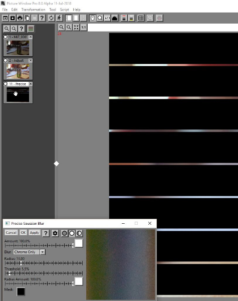

Double-clicking on the red image to re-open the transformation resulted in this:

I fixed the Shift-Click on Amount for Precise Gaussian for the next release - it was being updated but not redrawn.
I am aware of the Cancel issues.
