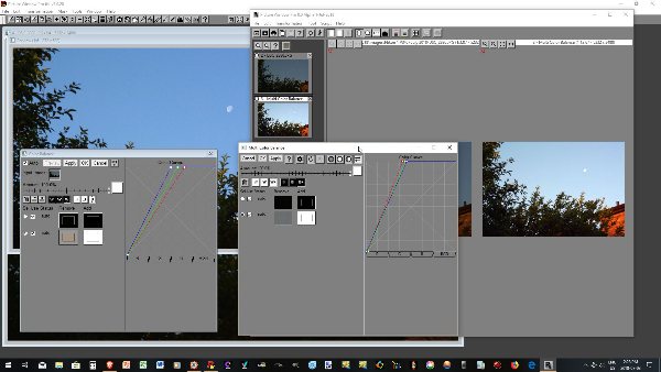

Just curious about the difference between how Color Balance in Ver 7 works compared to Multi Color Balance in Ver 8.
Ver 7 seems to protect the highlights more so than Ver 8, but maybe there's more to it?

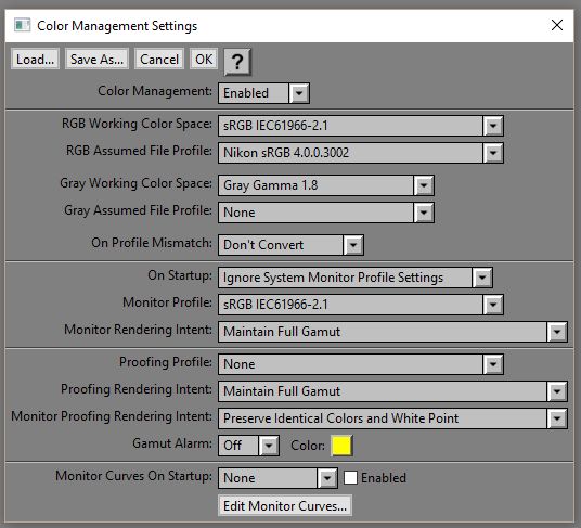

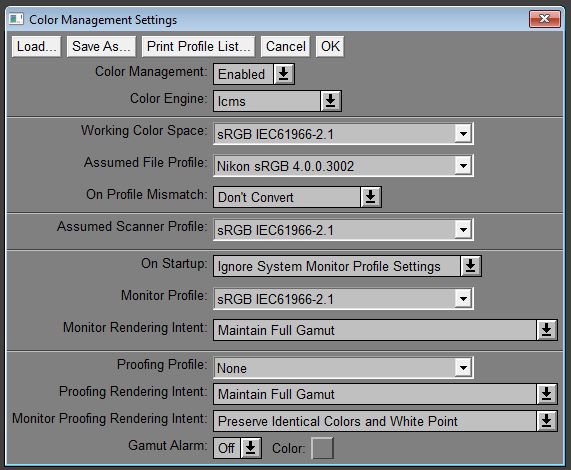

Here's the settings:
I've just downloaded 4-July and it appears that Ver 8 and Ver 7 results now look pretty similar. I'll try a few test images and report if I find anything interesting...
