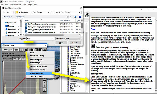

Not an immediate need [more of a reminder] but noticed that only *.cc files are recognized by the Color Curves transform Settings menu - Load Color Curves File dialog... ...the Help indicates the eventual capability to recognize/load Photoshop *.acv and *.amp files.
Load Color Curves File dialog_Help-1.jpg (278.69 KiB) Viewed 1957 times
Until this capability is available, one can Load *.acv files and Save as *.cc files using PWP7's Color Curves transform and then Cut/Paste them to PWP8's Color Curves folder.

It was an inadvertent omission. For the next release, I added support back in for reading ACV and AMP files. I don't have any AMP files to test on, but the ACV seemed to work fine.

Confirm that the 180519 updated "Load Color Curves File" reads/loads photoshop *.acv color curves.
