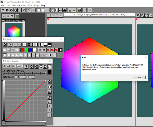

Got an 'error' message when attempting to Load an edited/saved *.mask file in the manner you suggested:
1) opened with Notepad, edited, and saved to Mask folder
2) tried to Load edited/saved file with Mask Tool upper Settings icon options
Screenshot mask file Load error.jpg (175.64 KiB) Viewed 5010 times
Same thing will happen with an added *.txt extension
Added edit: Seems to me that this same error will occur with the Tint transform when attempting to load a migrated/renamed PWP 7 *.cln file using the lower right Settings icon options.

Apparently Notepad and Wordpad do not read Unicode files with byte order marks (see Wikipedia) correctly. I use UltraEdit which works fine but costs $99 and is overkill for just editing settings and scripts. I tried EditPad Lite and it was able to load and save a mask file without mangling it, but it did not display the file properly. The one I tried next was BabelPad (http://www.babelstone.co.uk/Software/BabelPad.html) and it worked just fine, so that's what I recommend using, at least for now. It downloads as a zip file that contains the exe file - no installer, just run the exe to start it up.

I believe that the difficulty in using Notepad is that it encodes at UTF-8 but the PWP 8 Default Setting files are encoded at UTF-16. The BabelPad Save As shows UTF-16LE as its default encode.
Really do not know enough about this... ...it may be that the UltraEdit program default encoding is beyond Win10 64-bit Home OS Notepad capabilities.

Yes, I see the problem now -- unlike other text files in PWP, settings files are being saved as 16-bit Unicode with no byte order mark. I fixed this for the next release. I tested it and in the next release, you can now edit Mask files in Notepad again.
