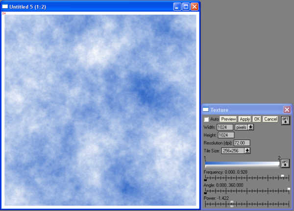

If you want more "light" clouds instead of that heavy cumulunimbus they can be created atrificially in PWP with Texture.
I create a new image with 1024 *1024 and set the tile size to the same size and then resizing the final picure to the needet size.
This is to avoid repetation effects when more the one tile is used.
Here a example:

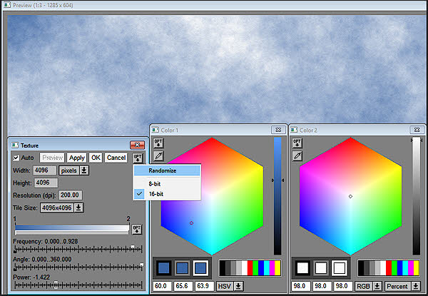

Administrator: -- a PWP7 updated illustration suggestion, July 21, 2017:
Notes:
1) No changes to Frequency, Angle, and Power;
2) Selecting the largest image/tile size of 4096 pixels will most likely eliminate the need to Tile;
3) Select Random and 16-bit from OPTions;
4) Color 1 where Hue = 60; Saturation = 65; and Value = 65 is a common sky/clouds image area tone/color at least for my latitude; and
5) Color 2 was set to 98% tone to avoid adding to any existing White point clipping
