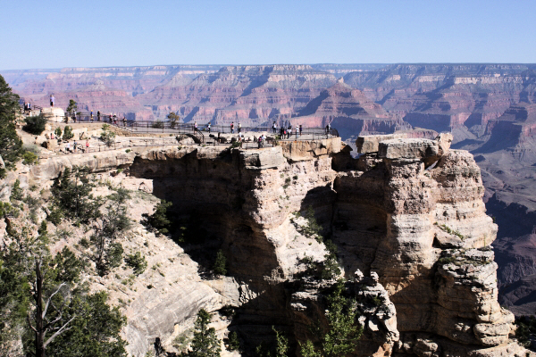

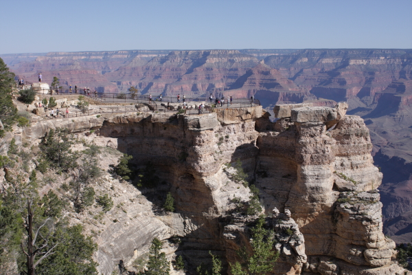

- what PWP steps could be used please on photos which have mild amounts of haze or mist to make the scene a bit sharper? (I am using RAW followed by processing in Canon DPP software.)
- I am aware that Canon software (DPP) offers Picture Styles - one of which is called "Clear" - it seems to increase contrast dramatically/too much to remove mist nicely.
- I have included small jpegs for Clear and Neutral picturestyles.

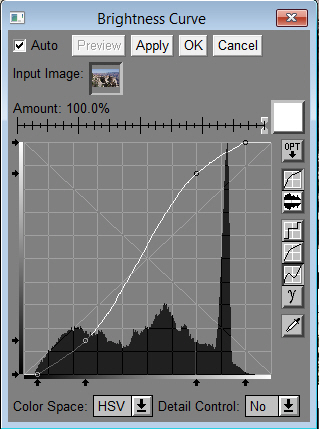

I tried to reproduce the anti-haze filter using PWP Brightness curve and saturation. It's not an exact match, but I think it is instructive.
First I loaded your before image and brought up the brightness curve. Notice that the histogram is zero at the very extreme left. This means that there are essentially no blacks -- your blackest areas are actually a dark gray. This reads as haze in the photograph. To correct this, just move the left point of the histogram to where the blacks start. (I also made a similar adjustment at the white end.)
Your image is also low contrast. You can increase apparent contrast by applying the S-curve. The tradeoff is that you will lose shadow and highlight detail. And in fact your output image loses all detail in the shadow areas. How much shadow detail you are willing to lose for improved contrast is a creative choice and depends on the image. I adjusted the curve to match the Nikon results as closely as possible. However I think if this were my image, I would back off a little bit to show more detail in the shadows.
Finally I also boosted the saturation by about 20%.
Here is the histogram and my final image:

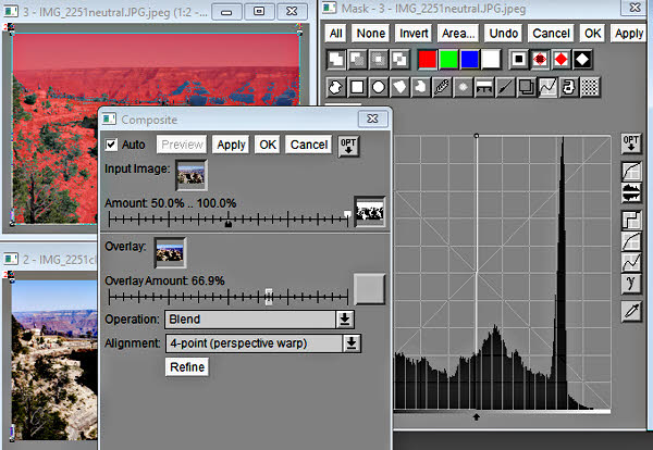

Perhaps this approach will help achieve a preference PWP Composite-Blend of an overly dramatic image version [high contrast] with its more natural verson [normal contrast] where:
Step1: lower-left Apply Add a Mask-BrightnessCurve StepStair: 0-0, 50-0, 50-100, 100-100; to Img1 and leave the Mask Tool 'active' [do not close]...
Step2: open the Composite-Blend transform where Input = Img1 and Input Amount Mask = the 'active' mask of Step1; Overlay = Img2... ...Note: to make the posted images 1:1 register, a 4-point Alignment was used as Img1 and Img2 had differring pixel dimensions but essentially identical scene content... Step3: adjust Input Amount Mask black and white and Overlay Amount sliders to preference while monitoring an updating Preview... ...click OK or Apply... ...OK or Close the Mask Tool... This is an adaptation of the theory/discussion described in the Tips Section here: http://www.dl-c.com/board/viewtopic.php?f=5&t=1020
...have fun...

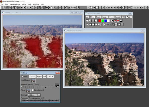

I've had some success with foggy, hazy images by using the Filter Transformation:
Basically filter the image with itself, and use a mask, if necessary, to preserve some details from the original.

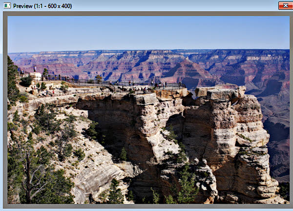

Yet another possibility using a favored nature Landscape USM Local Contrast Enhance transform to: (1) enhance large radius major edges; (2) control transform Amounts applied above and below 50% HSV-V tones; and importantly (3) limit Local Contrast Enhancement primarily to the 'dark' half of edges without generating 'white' half halos...
The suggested transform settings and mask [a Blur=2 was added following the applied curve (shown)]... The resulting Preview with added small detail Sharpening and slight increase in HSV-S saturation... Just exploring possibilities...
