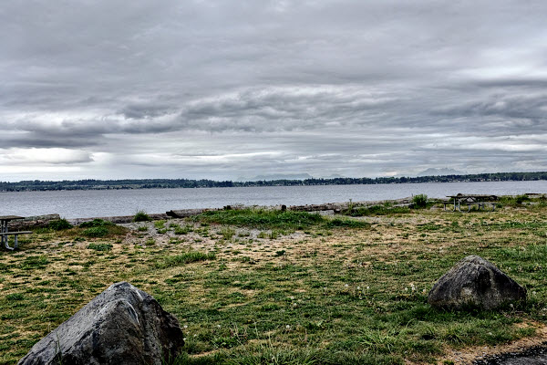

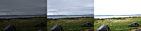

Example with scene exposures -1ev, 0ev, and +1ev...
Fusion result:
P.S. I tend to prefer HDR tone-mapping by SNS-HDR then fusion methods as the results can be more 'dramatic' depending upon the preset one chooses...
